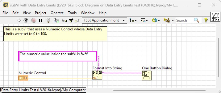

I was curious to test this, so created the attached VIs (LabVIEW 2016). They confirm that Data Entry Limits do not coerce the values fed by a caller VI to a subVI.
Screenshot 1: The subVI
Screenshot 2: Running the caller VI results in the uncoerced value being shown from inside the subVI
