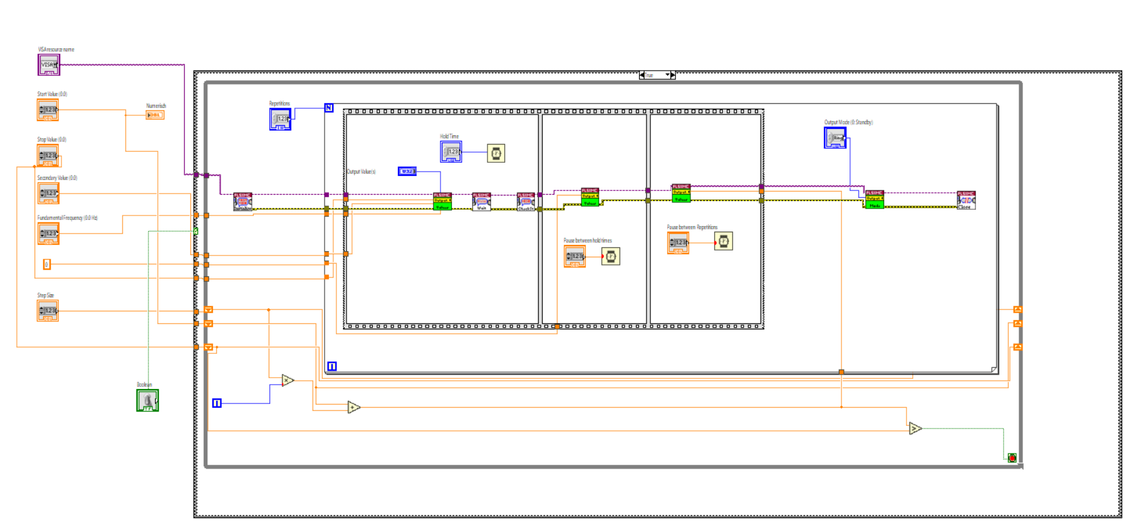

Thank you for reaching out. I did learned by myself some basic stuf and I kept searching for other information. I also I created a skript Python for it and it was successful, the thing is I'm not sure how to iplement it right that's why I asked for some guidance. However I tried to build in LabView, this screen shot shows.
Message 7 of 14
(1,345 Views)
Can you pls have a look on it and tell me what's wrong? I also updated the skript python so you can have an idea.
thank you so much
Message 8 of 14
(1,344 Views)
OK I started a simple queued state machine. I tired to make comments so you can see how this would work. This is just an example to get you started. We can add your code from here once you get your head around how this works.
