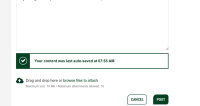

All you have to do is zip the folder that your code is in and drag it to the box blow that says "drag and drop here or browse files to attach"

I have draged the ZIP folder here, thank you for your help.
