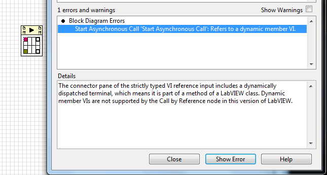

I'm wondering if it will be possible to use asynchronous call VIs with dynamic dispatch VIs (classes methods) in next versions of LabVIEW. When I try to do it, I get broken arrow with error attached. It ends with "in this version of LabVIEW" (i.e. 2011). Should this give me hope, that NI is currently working on such feature, or is it just my over-interpretation?;)

There is one obvious difference between a CBR node and a DD VI which would cause NI not to support combining them - with a DD VI, the decision which VI to call is made at run-time when you get to the VI call. With the CBRN, the decision can also be made at run-time, but it has to be made at the Open VI Reference node, not at the CBR node.
The two features probably could be combined (either by saying that the CBR node will behave differently from normal DD and only allow you to run the actual VI you referenced or by adding special code which will allow it to call the correct VIs), but I have no idea if such action has been taken for 2012. I would guess not, but you can probably find out in about a month.

You realize you can work around this by creating a non-dynamic-dispatch "wrapper" VI? You call the wrapper VI asynchronously; the wrapper VI then contains nothing but a call to the dynamic dispatch VI.
Not ideal, but workable.
