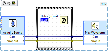

You can have software defined delay between, Acuire and Generation code. Something similar to:
Delay between Acquire & Generate

What about something like this?
I seem to remember not being able to share sample clocks across subsystems on myDAQ for some reason, so if that's still the case take out the sample clock source for the AO task.  You probably also should read a finite number of samples per loop (depending on your sample rate, say 1/5 of the sample rate) rather than -1.

I'm pretty sure I understand what you are asking.  The example I linked does what you are describing (but it might need to be slightly tailored for myDAQ).
