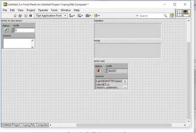

I am trying to authenticate and login to https web service via http client but I am getting an authentication error.

Probably a problem in the block diagram of the VI, or perhaps your username and password.
A picture of a front panel doesn't tell us anything.

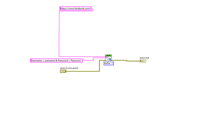

I tried multiple things and I am still getting the same error.
The last thing that I tried was below. When I am trying (http) the code is not giving me the error. But I am getting the error with https.

Again, a picture tells us nothing. Upload your VI.
