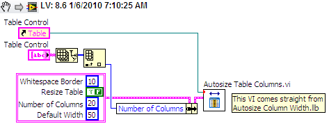

Like this 😄
Jim
(8,098 Views)

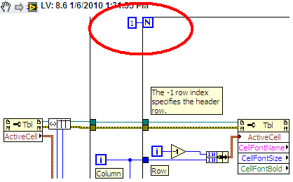

Oops.  My answer doesn't limit the autosizing to the column headers.  Add this constant to the sub-VI (or, you can remove the inner For Loop).
Jim
