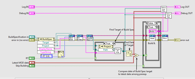

To avoid wasting time, I made an auto-builder.  It constructs a list of the LVPROJ files, in the build order and then consults the DEPENDENCIES of each target, to decode whether to build or skip this set of Build Specs.  Basically, if LatestModDate(AllSourceFiles) > ModDate(Target) then Build, else Skip.
The idea is to run one VI, and have it build everything that is necessary, and skip everything that isn't.
This all works well on the host (Windows) side.
But there are snags on the RT side.  Although I have it working, it is an ugly hack, and I would like to make it more flexible.

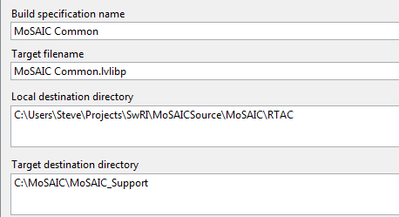

Issue 1:  For an RT target, the Build Spec includes a LOCAL DEST DIRECTORY, and a TARGET DESTINATION DIRECTORY, with a TARGET FILENAME:

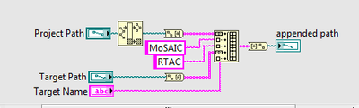

When building, LV concatenates LOCAL+TARGET+FILENAME to obtain the address on the host to store the file (in the above case, that works out to
MoSAICSource\MoSAIC\RTAC\C\MoSAIC\MoSAIC_Support\MoSAIC Common.lvlibp)
That's where on the host disk the file is placed.
In my build process, I need to obtain that path, in order to compare MOD dates, but I don't see a way to obtain the LOCAL DESTINATION portion from code.
I have found no way to obtain the LOCAL DESTINATION DIRECTORY from code.
There are BUILD methods which might yield it, but they are protected, and can't be called from outside the class they're in.
What I'm doing in the above, which works, is to detect whether it's an RT or not, and either assembling the path from the DEST PATH and DEST FILENAME (for a host target), or manufacturing the path by inserting constants (for an RT target).
So, the question is, How can I obtain the three pieces I need: LOCAL DEST DIRECTORY, and a TARGET DESTINATION DIRECTORY, with a TARGET FILENAME from the Build Spec?
Issue 2:  The BUILDSPEC property node has a property called TYPE STRING, which is advertised as one of "DLL", "Source Distribution", "EXE", "Packed Library", "RT EXE", and a couple of others.  The OPEN BUILD vi apparently creates a different class depending on the type it's given.
The trouble is, if the target is an RT EXE, the TYPE STRING does NOT come out as "RT EXE", but instead is a UUID (of the 8+4+4+4+12 digits variety).
In order to produce an RT EXE constant to give to the OPEN BUILD method, I have to ASSUME that if it's not "Packed Library" or "EXE" (the other kinds that I use), that it's a RT EXE.  That seems fragile.  I suppose I could qualify it as a UUID or not, but is there a guarantee that the UUID means it's an RT EXE?  I find no help info about this.
