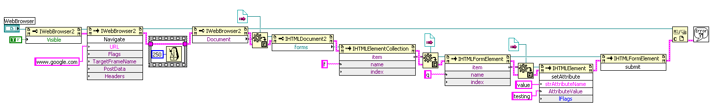

There is a way to do this using ActiveX and internet explorer.  This does require some research into what the HTML for that web page is actually doing though.  If you place the Web Browser ActiveX control on the front panel, you can set up a series of calls that will navigate to the web page of interest, then wait (time depending on the quality of the internet connection) then access the document property.  That will output a variant, which you will need to convert to a document reference by using the Variant to Data functions and the document ActiveX constant (right-click and select an ActiveX class).  This document reference can then be used to load the forms method.  This can be then used to get the specific form you would like, you need the element item, then the form element item, then you can set the attribute.  Once you have done that you can submit the form and then close the reference to the browser.  This is how I did it for Google, and searched for "testing".

Hi Andy F,
Any chance you can submit that Vi, or email that vi to me?, Ive tried and tried but cant seem to find some of the "things" you have on your diagram, mainly the IHTML Document thingy.

Hey Andy,
Thats the nice solution and i am also finding the problrm that Raj is facing, isnt it possible that you can attach the vi you have creatd, so that we can analyse it by run it, it is more understandable for me other then anybody.

Andy,
thank u very much..
i have some doubts in ur implementation..
in the IHTMLElement collection what does "f" mean as a name string?and in the IHTLForm element what does "q" mean as a namestring? and what does the strattribute name in IHTML Element("value") mean??
did you get these strings form the HTML soruce code of the "google page" ..if so please explain me the same. i have attached the HTML soruce code of google page also!!
i have one application where i should login with a password to an intranet website..(just enter the password and press login button..but it should be done like your implmentation in background automatically)
i have attached the source code of the HTML page of my web page and also the HTML page..for your reference
how to identify the "f" ,"q" and "value" strings for my implemention?

Andy,
Some of the things i tried for my implementation was..
i used "LOGIN" as the string for the IHTMLElementCollection for ""name"
but when i debugged with the help of probe the output of IHTMLElementCollection showed me value->0.
then i got an error..
the "LOGIN" string which i used was from the HTML code of the web page.It was given in the HTML page
<FORM name=LOGIN action="login.htm" method="post">
<input type="hidden" name="page" value="login">
<input type="hidden" name="GetTimeVal">
<td width=30>&nbsp;</td>
so i used the form name as the string.
But for the other two (IHTML Form element and IHTML element ) I dont know what do pass as string values form the
HTML code.
Please correct me if i am wrong
regards
vevek

Hi pondy,
the source of your login page looks a bit confusing but I think you should be alright if you use Andy's VI and just replace "f" with "Login" , "q" with "URL" and "testing" with your password.

thanks ravis..
but the problem is i have a html pages in frames ..i mean there are 3 frames are put into a html page!!! unlike google.com where there is only 1 html page.
when i call the url what i get is the main frame and under that there are 3 frames ...
i need one of the 3 frames and search for a form and submit the form!!!
Andy, is it possible to select a particular frame in html page and search  a form in that frame and submit it.
i have attached all the html files of my application in zip format!!
regards
vevek

Hi Andy,
You could see lots of mails in the forum reg this auto login issues.
I have said in my previous post that i have 3 frames of which i need one of the frame and in that frame i have the form where i should login..in labview we have
functions in ActiveX which can take frames from html page..but how to use those functions ..i mean the IHTML properties!!
could you please suggest me a way of doing the following in an automated way ..
1. login to a html page
2, get the frame which has the form for login(depending on the frame name. We would know it from the html code)
3. fill the form and press submit button
regards
Vevek

Due to popular request, here is the VI that I used, saved in LabVIEW 7.1.  To create the references that I used, I just copied the Web Browser, changed it to a constant, then right-clicked and selected the class taht I wanted.  Knowing which class to use is a bit of an experiment sometimes, so don't be discouraged!  It looks like from the source that you used, that the login.htm link is going to be the URL that you would need to browse to, since that is where the form that you are looking for is referring to.  From there you need to figure out what the form elements name is, and then which button will execute the submit button.
Hope this helps!
