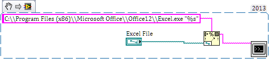

One simple way to do it would be to call excel with the command line, something like this: excel.png

Use the System Exec to call the file.  Windows will open it with whatever it thinks is the default application for the file type.
