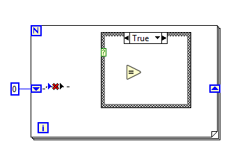

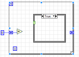

I just found out that if I have this diagram:

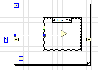

and drag/drop the "equals" into the case structure, the auto-wire function will create a new input tunnel to connect the constant there. The shift register will then be void:
I think it should be normal behaviour the leave the shift register wiring as it is.
Is this a known issue?

This is a known issue being tracked by CAR 718913
