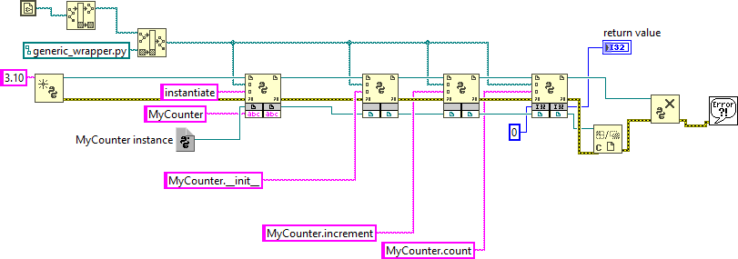

Not fun! Can we generate these programmatically? Yes! We can programmatically generate wrappers when the script is imported into the LabVIEW python session and get the methods we expect without creating static wrappers:
We pass in "self" as the 1st argument for each method call. The only truly weird thing here is the "instantiate" method call which we need to generate a "self" argument for the __init__() constructor call (one area for improvement would be making a constructor function that doesn't need the explicit instantiation).
See generic_wrapper.py for details. The idea is you would replace "script" in "import script as module_to_wrap" with the script you want to wrap (I'm sure there's a way to parameterize this, left as an exercise for the reader...).
