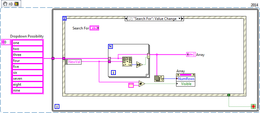

I've been hunting and searching for a solution in the LV forums to use an Autocomplete with a drop down menu.  Don't act like you don't know what I'm talking about.  You see it all the time in many different applications.  Heck even this forum uses Autocomplete with Drop Down (Attached).
I've seen recent posts that state "OMG only GOOGLE can do that fancy stuff, not mere LV mortals."
I think Labview is falling behind the curve with developer tools while other software continues to improve.  I've seen post here asking about this feature 8 years ago and still no answers.
I have other ideas I can use, but, they're not as graceful as a an Automatic Drop Down menu.
Here's what I need.  As the user types, a drop down list (from my ARRAY) is narrowed as they type.
The combobox is almost there...however, the combobox only works on the first match (doesn't show other matches), and it doesn't have a drop down, it does have pull down.
JQuery seems to be very popular today, has anyone tried using JQuery with Labview?
https://jqueryui.com/autocomplete/
Does anyone know how to  "Autocomplete with Drop Down" in Labview?
Doug

You can try something like this:

Thank you  gregoryj!
This will work!  Much better than anything else I've seen.  All I need to do is grab the "value" of the "Array" to extract the choice.  It's missing an autocomplete tab function, but, I'll settle for an addtional user mouse click.
Thank you!  Thank You!  Thank you!

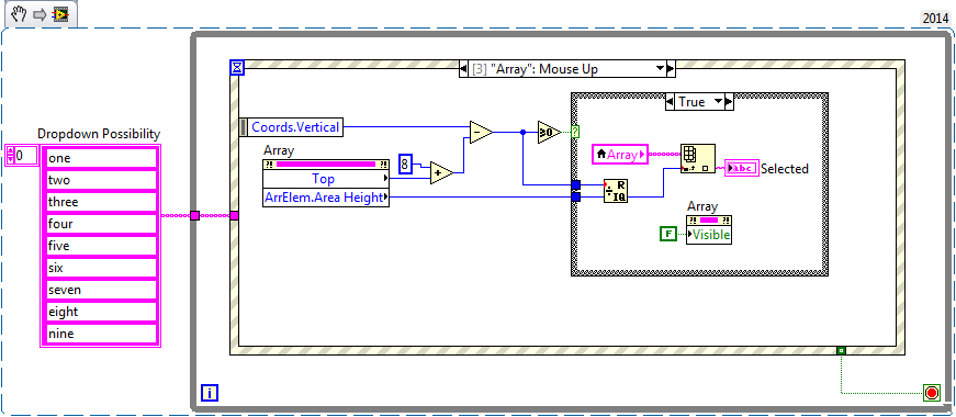

Glad to help,
I did forget the mouse click selection, this might do the trick:

Accepted by topic author Dhubbell
Or just update the box where you were already typing 🙂

Many Thanks gregoryj !
Brilliant!
I can see many people using this snippet over and over again.  I was completely surprised to find no answers and requests for this feature going unanswered for over 8 years.
Not only have you provided me something I can use, but, this will be a great building block for many other people.  Hopefully NI will see this and develop a common front panel add-on.  Autocomplete with drop downs is in every application now a days.
Thank you again for your help and support.
Doug
