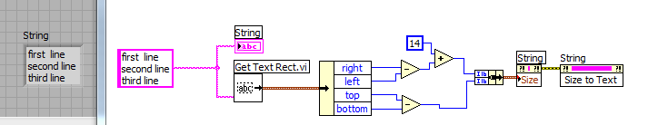

The GetTextRect function is working perfectly for me for the first line of my string.
My string is made up of multiple concatenated strings with carriage returns added.
The string indicator isn't sizing itself to incorporate the additional characters on the other lines.
See below for a simplified version of the code I am using.
I input a string constant that contains three lines, but when i size the box it only includes the first line.
The left shows the indicator on my front panel and the right shows the code that generated it.
-Eric

Accepted by topic author EricBSEE
Would the "Size to Text" Invoke Node work?
Omar
Message 5 of 8
(4,636 Views)
You are definitely close Omar_II
Using a 'size to text' invoke node now shows all off my text, but splits it in half.
Any ideas on how to get it all on one line?
I suppose i could specify the width left to right since my "The following parts are missing:"  line is so long that nothing else will probably be longer than it.
But it would be nice to have the string indicator just show everything automartically without me fixing any sizes with a constant.

Omar's soultion was correct.
It actually turned out that i had a small glitch in my main code casuing the resizing to not work.
I tried it out on my simplified code that i used as an example and after adding the "size to text" invoke node after the GetTextRect.vi code, the box is now the right size regardless of what i send to the string.
Thanks!!
