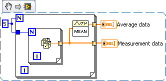

You are running a while loop inside a for loop is not a good idea you can use nested for loops instead and can give some defined numbers of execution. Use of build array inside loop will consume lot of memory so it is not recommended. You can use your auto indexing tunnel to build the array and find the average and also gather all the measurment data. Take a look at the attached snippet.
This is just an idea to start a easy code.
