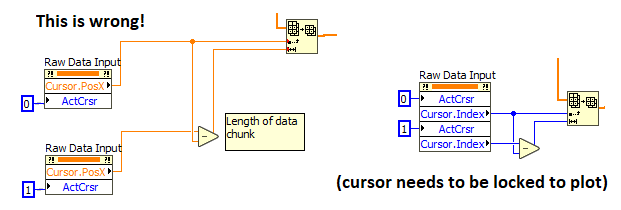

Property nodes operate top to bottom, so if you read the cursor position before setting the active cursor, you are reading the position of whatever the currently active cursor was, which might be unpredictable.
It is also better to read the cursor index, which gives you directly the right index value of the array elements (but the cursors need to be locked to a plot).
You also probably want to insert a "Max&Min" to make sure the indices are sorted.

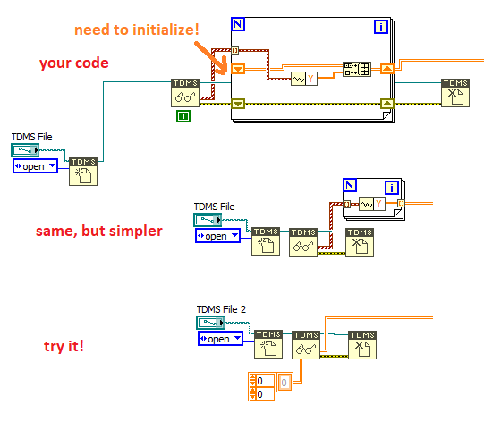

First things first: In your first small FOR loop, you need to either initialize the shift, or even simpler, just autoindex at the output tunnel. No shift register needed (See picture).
Also, the entire code seems inside/out. You should have an outer while loop and no inner while loops and a state variable that selects the current state based on the tab, for example.

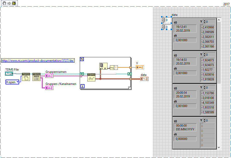

It looks like da325 is struggling to read out all 1d-array data from the .tdms file, which works like this:
Message 8 of 8
