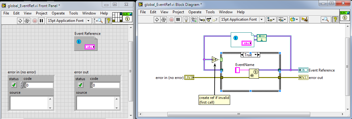

I have been bitten before where I have a couple of asychronously-launched VI daemons that need to register for/generate some commonly-shared event. I have a simple action engine that creates the Event reference on first call and stores it in a feedback node, providing functional-global variable (FGV) behavior; each daemon can just plop down this FGV to have access to the reference.*
The problem, then, is that the first daemon to call that action engine/FGV will "own" the reference, and if that daemon instance is killed, then the reference dies with it, even if other daemons are still running. I would like to find a way to prevent that garbage collection--to keep the reference alive even if its "owner" stops running.
Sure, the simple solution is to drop the FGV on the top-level diagram. But let's assume I can't (or don't want to) do that any time I add one of these FGVs. Is there a way I can effectively tell LabVIEW: don't ever destroy this reference automatically? Has anyone encountered this problem and found a good solution?
