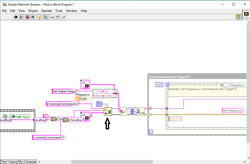

Unbenannt.pngHello there,
i want to start a network stream and i tried to understand this with the "simple network streams - Host/Target"
i've reduced the example in the way, that only the host ist sending data to the target.
For the real measurement system i want, that the host try to send all the time, also if the reader is not reachable.
In the example, if i try to run the host and not the target and change the values the create network stream writer don't pass any value, not even an error, so the whole program gets stucked.
Is there any possibility to skip this step (something like: after 1 second, if no reader was found restart)?

If you set the Create Endpoint function with a TimeOut (other than the default -1, which waits for 7 weeks, at least), when the TimeOut expires without a connection, the function will return an Error.  You can use that Error to do whatever you want, such as loop back and wait again, or "proceed without a Network Stream Connection" (be sure to clear the Error -- the Clear Error function does a clean job of this).
Bob Schor
P.S. -- attaching a Project file for your project is almost useless, as it points to files on your hard drive.  Better would have been to say "I'm using the Simple Network Stream Example that ships with LabVIEW".  Sending a picture of a Block Diagram is also not as helpful as actual code, i.e. a .VI file.

At first thanks for your quick awnser!
I'm sorry for the circumstances, hopefully this time the VIs works.
I'am a little confused because as long as no timeout is connected (and as long the reader is running) it works.
If i connect the default value of -1 it get stucked.
