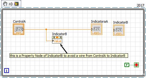

@Blokk , Thank you very much for the link, now i really understand the importance not to use local variables everywhere!  Could you please take a look at the file attached to show me how to accomplish not to use local variables that way.
Thanks again.
Message 15 of 16
(1,969 Views)
Thanks again.
You example is too simple and anything we show you will be more complicated than using a local.
But how about this? 😛
If you are worried about a "messy" block diagram think about using sub-vi's and clusters, NOT local variables or Property Nodes.
