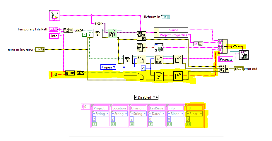

I have one vi where I save a .rtf file to a database like so:
Upload From ComputerUpload From Computer
Later, I get the file from the database and save it as an .rtf before I open it with another vi (*rtf viewer.vi*):
Download from DBDownload from DB
However, Although *rtf viewer.vi* will work with files that are not uploaded to the database, it cannot read these files. Opening a file in Notepad++ gets me the following:

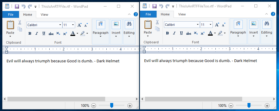

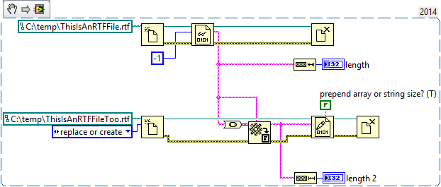

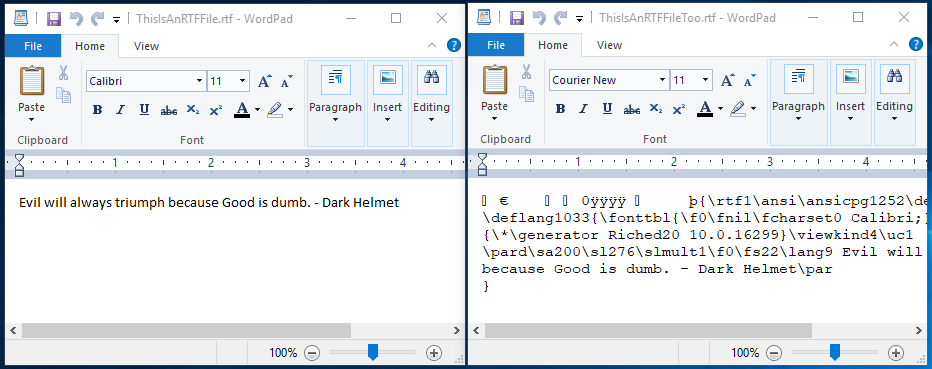

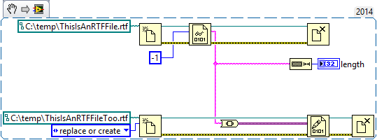

I more or less tried to replicate the issue by converting to Variant and saving the data directly to file and got something similar to what you're seeing.  The variant has a bunch of extra bytes, probably to describe data types and sizes.
If I convert the variant to string and then make sure I set the Prepend Array or string size? boolean to False, it saves the RTF file correctly:
