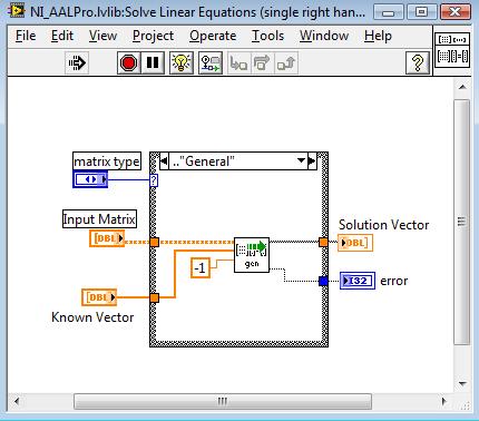

I am using 8.6.2. With spline intepolation, it also locks up. Just want to know if this bug is fixed or not. Here is where it hangs. Any get-around solutions?
.LabViewSplineFitLockup

The error is caused by your last pair of points. It seems that the algorithm is waiting for another pair to compute the i'th B-Spline pair. If you don't use the last pair as showed in the snippet the vi will not hangup.
Ben64
