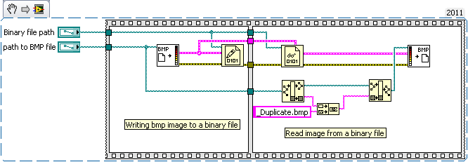

Converting simply a file that is in a specific location means you can follow the code shown below
But am not sure about the MacOSX.

Thanks a lot ! 🙂
It's what i needed !!

In the example provided I see that a sequence structure is being used.
In this case however you could just remove it, because it doesn't seem to serve a purpose.
Please also check this link about when to (and when not to) use sequence structures:
https://www.ni.com/docs/en-US/bundle/labview/page/determining-when-to-use-sequence-structures.html
