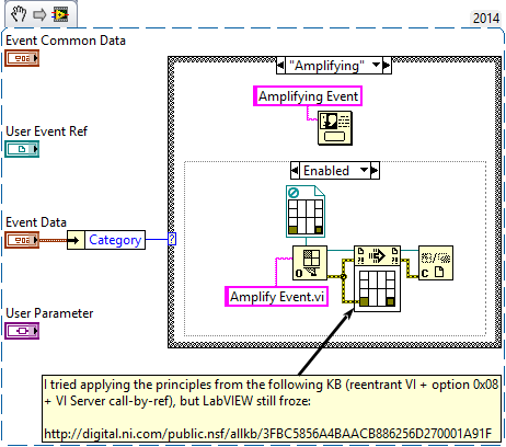

If an event callback is activated, and the callback VI in turn calls the VI which originally registered the callback, something weird happens. LabVIEW will continue running normally and respond to all kinds of user input. However, when the time comes to transition from Run mode to Edit mode, LabVIEW will freeze. Changing reentrancy did not help. Switching between direct subVI calls and VI Server calls (call by reference) did not help.

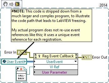

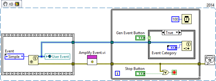

Main.vi
Amplify Event.vi
Callback.vi

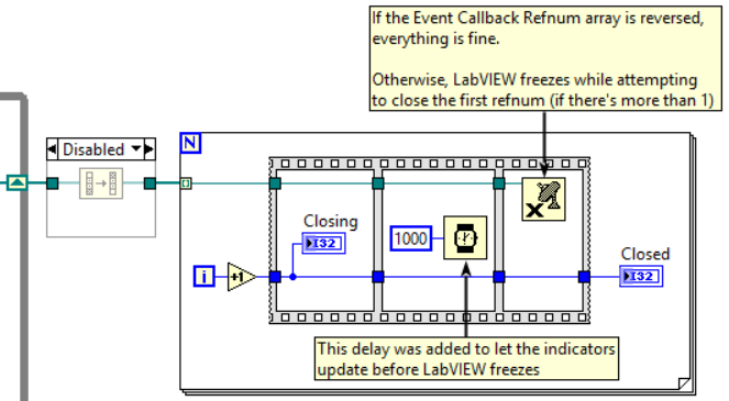

I extended your code some more and found that the freeze occurs when closing the very first Event Callback Refnum. In the code below, "Closing" will never go above 1, and "Closed" will never go above 0 if there are multiple cascaded callbacks:
So, I'm guessing that when I didn't explicitly close the refnums, LabVIEW tries to auto-close them when I stop the VI. However, it tries to auto-close them in the order they were created, hence triggering the freeze.
This behaviour reminds me a bit of how a DVR becomes invalidated when the VI which created it leaves memory. Perhaps, by closing the first Event Callback refnum, LabVIEW tries to "unload" the callback VI, which in turn tries to close the next Even Callback Refnum, and so on.

Accepted by topic author JKSH
This is now being tracked under CAR 690115.
Issue summary: Suppose a callback VI registers another callback. LabVIEW will hang if:
  • We try to unregister the first refnum before the second refnum, OR
  • We we stop our code without explicitly unregistering anything (which causes LabVIEW to do automatic cleanup behind-the-scenes)
Workaround: Always ensure that our code performs the un-registration in reverse to the registration order.
