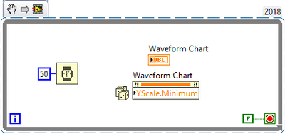

BUG: Graphs automatically resizes when scale min\max is changed
When the Y scale of a small graph\chart is changed (just setting it doesn't work), the graph\chart is resized to some value...
Often this happens the first time, but in the examples I put a loop around it to make sure the demo shows the problem.
This was no problem in LV2013, but it is in 17 and 18. Haven't tried 14, 15, or 16.
(2,475 Views)
Accepted by topic author wiebe@CARYA
This doesn't happen when Advanced>Auto Adjust Scales is turn off. And that why I posted the bug here, so it might help someone someday.
Not sure what to do if you need Auto Adjust Scales to be on... Probably get the size, change the scale, set the size back (inside a defer panel update)...
