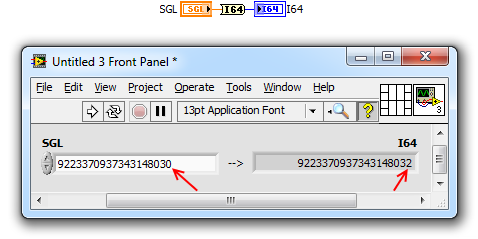

When using the conversion "bullets" to convert SGL, DBL and EXT to integers there are some values which convert wrong. One example is the integer 9223370937343148030, which can be represented exactly as a SGL (and thus exactly as DBL and EXT as well). If you convert this to I64 you get 9223370937343148032 instead, even though the correct integer is within the range of an I64. There are many similar cases, all (I've noticed) within the large end of the ranges.
This has nothing to do with which integers can be represented exactly as a floating point value or not. This is a genuine conversion bug mind you.

9223370937343148032 won't be accepted when entered in a SGL in LabVIEW, but that wasn't the number I wrote. 9223370937343148030 will be accepted though (note the "0" at the end vs. the "2"), which was the SGL I wrote. The former number is the number that SGL is converted into.
But, your reply prompted me to take a look at the binary representation of this SGL in LabVIEW, and when I enter 9223370937343148030 into a SGL constant its binary representation is as follows:
Sign: 0x0b
Exponent: 0x10111101b (0x189d)
Implicit integer: 0x1b
Fraction: 0x11111111111111111111110b
The IEEE 754 single-precision binary floating-point format conversion to real number formula is (-1)^sign*(1+SUM(i,1,23,fraction_bit_23-i*2^-i))*2^(exponent-127). With that I get 1*(1+4194303/4194304)*2^62 which is the integer number 9223370937343148032. And that is exactly the returned number when you convert to an I64 in LabVIEW.
So now the bug is identified as being in the SGL display code (within constants and within controls/indicators) then? Documentation:
The number in the SGL control on the left in the above picture shouldn't be possible, as the binary representation of the SGL ends with the decimal digit 2, which internally makes the number identical with that in the I64 indicator on the right. Therefore you're right that the conversion is correct. but the numeric display of some floats in LabVIEW is buggy then.

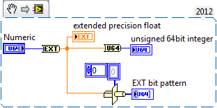

Ok, definetely a confirmed bug when converting from EXT to U64:
I've attached the VI as well (LV2011 SP1).
@JLewis: Will you report this through the proper channels?

Hi Steen,
Thanks for identifying this. I have confirmed the EXT to U64 conversion problem by simply attempting to round-trip a U64 value xFFFFFFFFFFFFF9B0 to EXT and back, getting xFFFFFFFFFFFFFFFF as a result (and the intermediate EXT value is correct).
The problem seems to be restricted to integer values with all of the top 53 bits set, along with one or more of the lowest 11.
I have reported this (#396305), along with the limited display precision issues (#396337).
Jim
