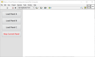

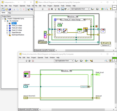

The main UI contains a subpanel. The buttons on the left switch between various content panels by loading different actors. (The attached example uses AF, but any asynchronous call seems to trigger the bug.)
The load sequence for each panel is identical:
We first stop* any existing panel, then pass the subpanel reference to the new panel, then launch the new panel. When each new panel actor starts running, it inserts itself into the main subpanel, then waits in its message handling loop until stopped. (See screenshots below for Panel A, B and C.)

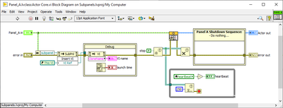

There are three different versions of the content panel which all begin the same way: Insert self into the main subpanel, then run Actor Core. For debug purposes we also display the VI name, launch time, and a blinking indicator to show when the actor is running. Panels A, B and C differ only in their shutdown behaviour.
Panel A has no special shutdown behaviour, so it generally stops completely before any new panel is launched. In practice this is not very interesting. Issues only show up when the shutdown of one process overlaps with the launch of the next.

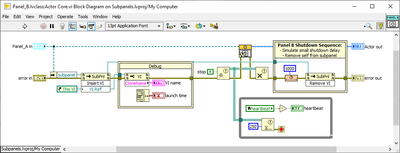

Panel B includes a small shutdown delay, then removes itself from the main subpanel. This is where the fun begins...
  • I added the call to RemoveVI to ensure that Panel B would never be left inside the main subpanel after it stopped running. (This made more sense in my original application where panels could sometimes stop without being replaced by a new panel.)
  • This caused a problem though: Because stopping a panel is asynchronous, if the shutdown takes long enough then the main subpanel may already contain a new panel. In this case the call to RemoveVI will incorrectly remove the new panel by the time the old panel eventually stops.

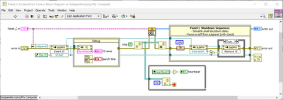

Panel C is just like Panel B, but includes an additional check using the InsertedVI property.
  • RemoveVI is only called if InsertedVI returns the current panel (in this case Panel C). If a different panel is already loaded, then we do nothing.
  • This is where the bug occurs: Once Panel C completes shutdown and goes out of memory, the VI returned by InsertedVI is unloaded from the subpanel and cannot be reloaded.

  3. You still have a race condition in the following image, because you check for a VI and then remove it. In between, the VI could be replaced by the new VI and then you're removing that one. This is a narrow window, but it's still two separate operations. Again, changing the way you manage this can help.
