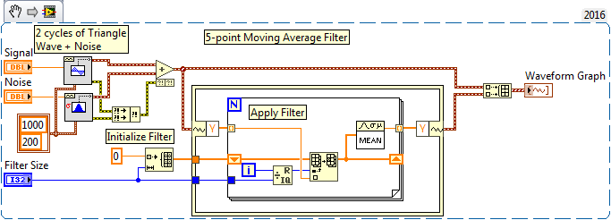

When trying to implement "something new" like a Moving Average Filter, it is sometime useful (and instructive!) to write a little Demo program where you make up data that are simple and understandable and test your algorithm on that.  With a simple system, you can play and tweak and figure out how things work.
I'm also thinking that you might not be so familiar with Digital Filters, where "time" is quantized and can lead to "unexpected" situations, particularly at the beginning and end of the signal.  You can often see these effects (and think about how to handle them) with your Demo.
So, here is a Demo Simple Moving Average.  It's pretty much all in the Snippet, but I've also attached the VI (unless I forget).  The Snippet and code are in LabVIEW 2016, but it should be simple enough that you can create it "from scratch" from the Snippet image.Simple Moving Average.png
The two Functions on the left are from the Waveform Palette and are Function Generators.  The top one generates 2 cycles of a 10 Hz Triangle Wave sampled at 1KHz, while the bottom one generates Gaussian Noise, which are added together to make a Noisy Triangle Signal (I chose the Triangle because it is easy to compare the effects of the Filter.
We initialize the 5-point Moving Average by creating a "Filter Memory" having 5 zeros.  The Filter takes the Waveform Data Points (Y) and replaces each point with the average of that point and the 4 preceding data points.  Do you see how we use the Remainder function to convert the Point Index, "i", from 0..199 to 0..4 (so we save the latest point in positions 0, 1, 2, 3, 4, 0, 1, 2, ...)?  Finally, we plot both the original ("noisy") data and the filtered ("smoothed") data on the same graph.
Try running this.  You should see the effect of the filter quite readily.  Do you notice any difference between the input (white) and filtered (red) signals?  Look at the positions of the peaks, and also examine the first few points.  This may be clearer if you re-run this after setting Noise to 0.  You can also change the filter size to a larger number, which will make the difference more obvious.
For a finite data sample, digital filtering means that you essentially "lose some points" and some information (but you want to lose some "information", namely the noise ...).  Why don't Analog filters "lose data"?  They do, it's just that we rarely look at them during the first milliseconds that they are on.
This is not exactly the code I described earlier -- there, I "pre-initialized" the filter by giving it the first 5 numbers, and started filtering from the fifth data point.  But this simpler example, I think, demonstrates Moving Average Filters in a simpler manner and shows some of the important properties of such filters.  At some point, you will learn about Low Pass Filters (this is an example of such a filter), and will learn that they introduce a "Phase Lag" in the signal.  "Phase Lag" is to Frequency as "Delay" is to Time.
