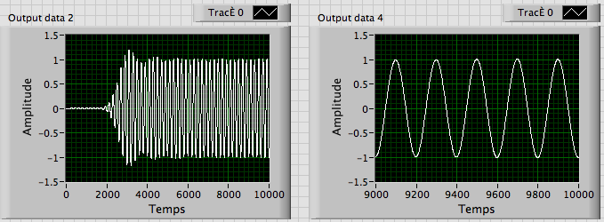

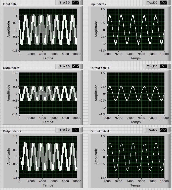

By comparison I connected a Butterworth Filter.vi to your data.  I selected Bandpass as the filter type and wired Ordre du filtre, the pass freq controls, and Fe to the appropriate inputs. This filter works over a wide range of settings.  The Butterworth filter has a very smooth passband although its transitions to the stop band are slower than many other filter types.  The image below has the original data at the top, the Equi-Ripple filter in the middle and the Butterworth filter at the bottom.  The graphs on the right show the last 1000 samples so you can see the nosie removal effects.  Also note the phase shift. All graphs have the same Y-axis scales. Note the initial transient on the Butterworth filter.  All filters have such transients. I suspect that the Equi-ripple may be trying to compensate in some way and that may be where the problem occurs.
This image shows the effect of the Butterworth filter with your default settings (Ordre = 24). The Equi-Ripple VI generates an error at this setting.

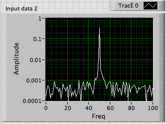

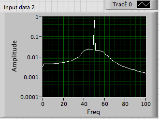

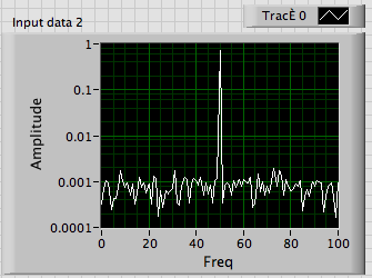

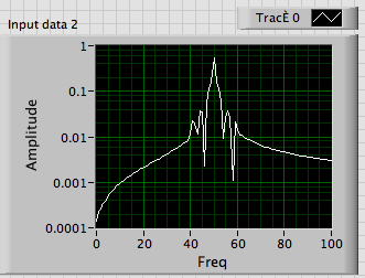

It often helps to look at the spectrum of a filtered signal.
Input spectrum.png Input spectrum
Equi-Ripple Ordre3.png  Equi-Ripple Ordre = 3
Butterworth Ordre3.png  Butterworth Ordre = 3
Butterworth Order24.png Butterworth Ordre = 24
I have enclosed the VI which I modified so you can try various parameters for yourself. Unless you have strong interference in the stopband, I think the Butterworth filter may be adequate for your needs.

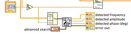

Have you tried frequency domain methods? You might be able to get the data you want by using Extract Single Tone Information.vi from the Signal Processing palette. When I run it on your raw data it returns frequency of 49.999946 Hz, amplitude = 0.99951, and phase = 1.63 degrees. Given the noise on that signal, you probably will not do much better.  When I run it on the filtered signal the values are f = 49.885598, A = 0.92794, theta = -57.87.
If you have strong interfering signals the advanced search should help.
This is what I added to the VI I posted the other day.
Lynn

No I haven't tried this but it seems to be exactly what I want to do !
But I have a question : What treatment is there in this VI ? How could he find such results with my input signal (sinus 50Hz + 10% noise signal + temporal distorsion on each point) ?
I will work on it to find what kind of functions are behind this...

You can open the block diagram on the Extract Single Tone Information.vi to see what is in there.  Ultimately it uses a Fourier Transform.
The nice thing about using the frequency domain for this kind of problem is that the Fourier transform of the noise is spread over the entire spectrum while all of the signal energy is in one place.

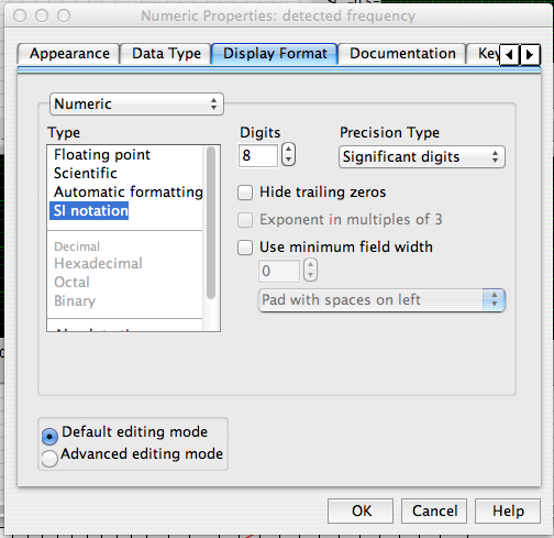

Yesterday, I tried to use the Extract Single Tone Information.VI but I have a problem about the accuracy. On my computer, the frequency is approximated to 50.00 Hz... How could I fix the number of significant numbers to have 50.000001 ? I searched in the subVI about a %Xf but I didn't find it...
Could you please tell me how I can do that ?

Pop up on the control on the front panel and select Display Format... or Properties from the menu. You can change the number of digits and whether it uses digits of precision or significant digits.
Internally the wire always maintains the full precision of the datatype (~15 digits for DBL).
