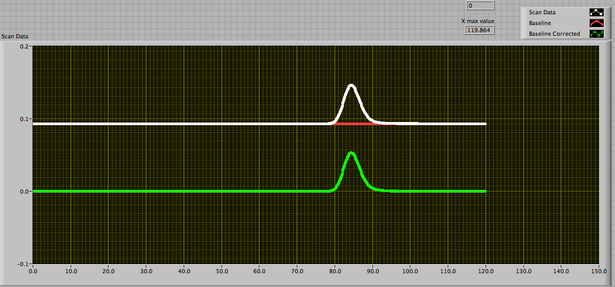

Could you help me with this, I am trying to apply it on a ppg signal.
I want to have them on the same line as this.
