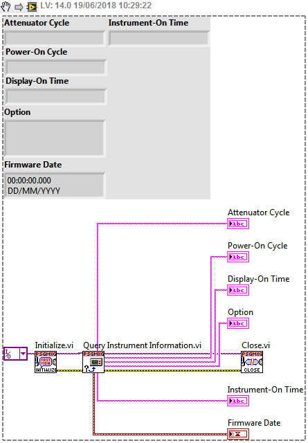

First just test the unit with something simple, like an info query:
(and put an error indicator at the end to see the error info if there is any)

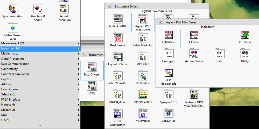

where can I find those blocks? the initialize , query and close because I don't find them even with quick drop
Message 24 of 26
(2,310 Views)
Accepted by topic author Matanlaza
Not blocks, VIs 🙂
See the screenshot below how to find these driver VIs, but actually in a previous post I showed you where they are in te palette menu. Never mind, I explain again:
Open palette from Block Diagram --> Instrument I/O --> Instr Drivers --> Agilent PSG MXG Series -->
Here you can see the Initialize and Close VIs, you ALWAYS start with the init, and finish with the Close your code. You can find the "Query instrument information.vi" under the "Utilities" subpalette!
