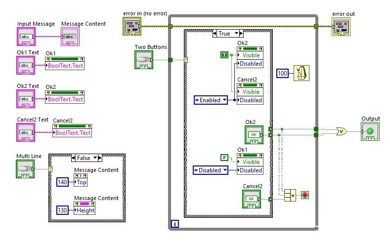

I made a simple custom dialog that basically takes a boolean input to indicate if it has 1 button or 2 buttons, a boolean to indicate if it's single lined message or multilined message, and 4 string inputs that modifies the text property of the buttons/message box.
The subvi is used in multiple places in top level VI to popup alerts/warning messages in the front panel. It is set as modal window. The weird thing is, on my dev computer, the custom dialog works fine as expected and loads the strings properly and quickly.
However when i export to an exe to a slower 1.8ghz cpu computer, the second time I call the subvi it would briefly show the messages/buttons from the first time it was called, flash white and then update with the input given.

Below is the custom dialog block diagram.
