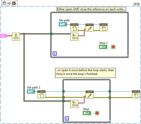

Note that you could use a shift register in the second loop, but since it's a reference it shouldn't matter for this case.

As a quick further note on references and shift registers:
  • While loops will always execute at least once. So a tunnel is fine provided you wire it through
  • For loops can execute zero times (depending on the way their iteration count is controlled - e.g. empty array set to autoindex). This means that the value out of tunnels is the "default default" for the type, which for a reference is invalid. So use a Shift Register with a For loop even with references if the number of iterations can ever be zero (even if you don't expect it to be zero).

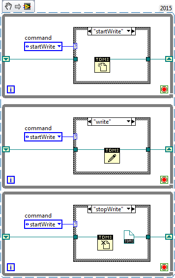

Naturally, it is crazy to open and close the file at every step.
It is very possible to open the file “before” the cycle, for this you need to learn two simple mechanisms: a state machine and a shift register.
Here are three cases in ONE loop. You do not need to do three separate cycles, I showed them only to understand what is happening in hidden cases.
