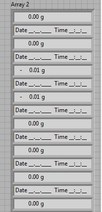

Hello everyone. I have have an array where i can write two different strings for my scale, and read it after. The array looks like this :array1.png

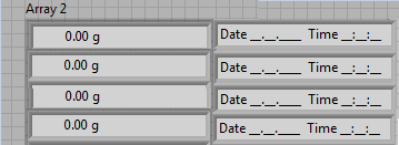

I have to make measurements and transfer the data to excel, so i want my array to look like the picture shown to the right array1.png
How do i do that ?. My VI is uploaded

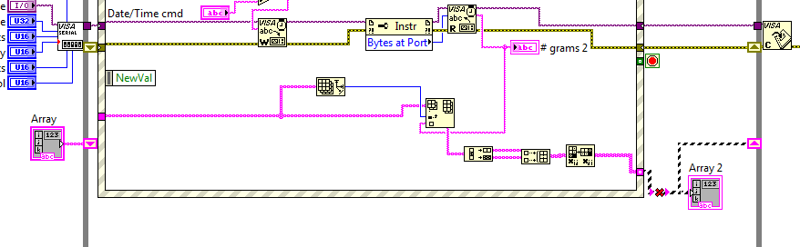

A simple way of getting from your first array to the second array is as follows:

Hi Oesen,
Use Decimate 1D array function to seperate the data and then a build array function.
See the attachement and check whether it meets your requirements.

Hmmm... When i use that procedure, it says error at the end, when i wire it to the shift register ?

Hi Oesen,
Array 2 is an 1D array where as the resultant array as per your requirement is a 2D array.
Right click and add dimension to make a 2D array
Gogineni
That's because 'Array' is a 1D array whilst 'Array 2' is a 2D array, so they cannot be stored in the same shift register (different data shape/size).  I would chose to remember only one of the arrays (probably the first, since that holds the raw data) and simply reconstruct the other array as and when needed.
Another possible option is to only work with a 2D array, but you would have to work out which row/column to instert the new element whenever you enter new data.

If you always want the date/time after taking a measurement, your code makes no sense. Add a second write and read to the Measurement Value Change event. then you can have one indicator for the weight and one for the date/time. Change the mechanical action and get rid of that select statement. In the event, build a 1D array and have a 2D array as the shift register value.
It also seems silly to have front panel controls for the different commands. You want the user to be able to screw things up? That is what it seems like,
p.s. It is also silly to specify a read termination character and then use the VISA Bytes at Serial Port.

@Oesen wrote:
What do you exactly mean with "remember" ? 🙂
By "remember", I mean to store one of the arrays in the shift register.
However, Dennis' suggestion of storing the 2D array (in the shift register) and simply appending the 1D array of new data to it (each time it is read) is probably better.
