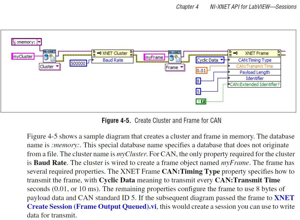

Baud Rate into a XNET Cluster
In the insert below it shows 500000 being added to the XNET Cluster.
When I try to do the same I find that Baud Rate is not in the pull down menus.
So how do you get it to do what it is showing.
Is there a problem or am I just doing something wrong

You can probably just use the 64-bit Baud Rate cluster property instead.  NI should update this documentation.
That image is still in the XNET 20.1 documentation (https://zone.ni.com/reference/en-XX/help/372841AC-01/nixnet/databaseprogramming/) and is identical to the page in the old XNET Hardware and Software manual (https://www.ni.com/pdf/manuals/372840k.pdf).  The old documentation mentions a Baud Rate property (that is 32 bits), so the "Baud Rate" property probably got deprecated in favor of the "64-bit Baud Rate" property at some point.
I decided to see if any of the XNET examples show you the correct property, and I found one using the (likely deprecated) "Baud Rate" instead.  It is Editing Database with IO Control.vi (and can be found in the LabVIEW example finder).
