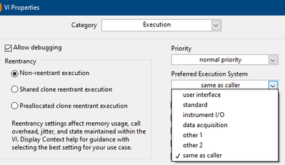

Next, you could try changing the executing system the VI with the constructor node runs under.  Some .NET seems to behave differently when it's in the User Interface system:
There's a file that affects how .NET runs in an EXE, which in dev is either "LabVIEW.exe.config" if you don't have a project open or "Projectname.lvproj.config" if you do, or if you run an EXE it's "Appname.exe.config".  I don't know what exactly you might need to set in there, but there's bunches of options you could play with.  Do a few searches for the format (it's XML but needs specific nodes to do anything).  For some DLLs I have had to enable certain runtime versions or <loadFromRemoteSources enabled="true" /> or the like.

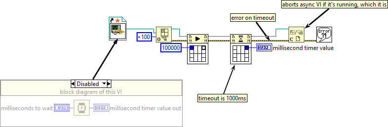

Finally, the last thing I can think to try is that maybe you could run the constructor node in a reentrant VI that you run asynchronously which is set up to send the message back using a queue or something similar when it completes.  Then if you don't get a queue message within your timeout period, start up another reentrant instance to try again.  Might need to close the reference or abort the first one to get the next one to work, not sure.
(1,747 Views)
You can also use "wait on asynchronous call" to get the output at the end. If you open a VI reference with "call and collect" enabled you can wait for the VI to finish with a timeout and then conveniently abort the VI by closing the reference.
