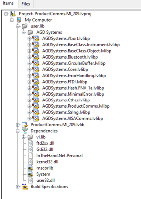

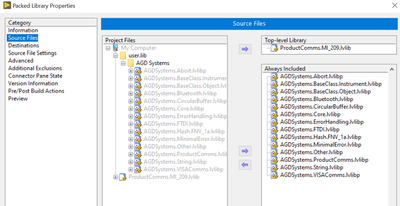

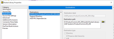

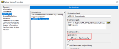

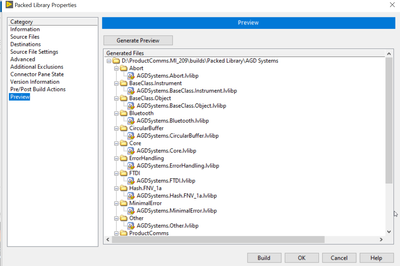

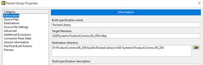

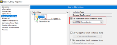

Not sure if this will help, but if you build the PPL and explicitly include the dependencies as items in the project and build, it should keep all paths relative (providing they all have a common top-level directory).
For my PPLs built for use in user.lib, I move the PPLs in the Dependencies item in the project to a virtual folder called user.lib. LabVIEW seems to be poor at automatically including PPLs that reference other PPLs even though they are listed as a dependency, so this method gets around that (may be fixed in >2018). The only drawback is that the contents of the static user.lib virtual folder need to be manually updated if something changes (delete all items from user.lib and then move all items from the project dependencies back into there).
Example structure:
PPL build spec config:
PPL dependencies -> Always includedPPL dependencies -> Always included
The contents of the destination/build directory should then be compatible with the intended user.lib layout and the built PPL will have relative links to its dependencies (../<lib name>/<lib name>.lvlibp) instead of absolute paths to C:\<path to LabVIEW user.lib>\
