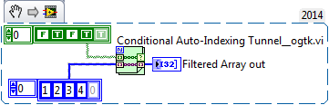

gregoryj a écrit :
Pre-allocation is not necessary, the for loop will take care of that.
Note that there is an OpenG vi from the OpenG toolkit that does that
Ben64
(4,678 Views)
