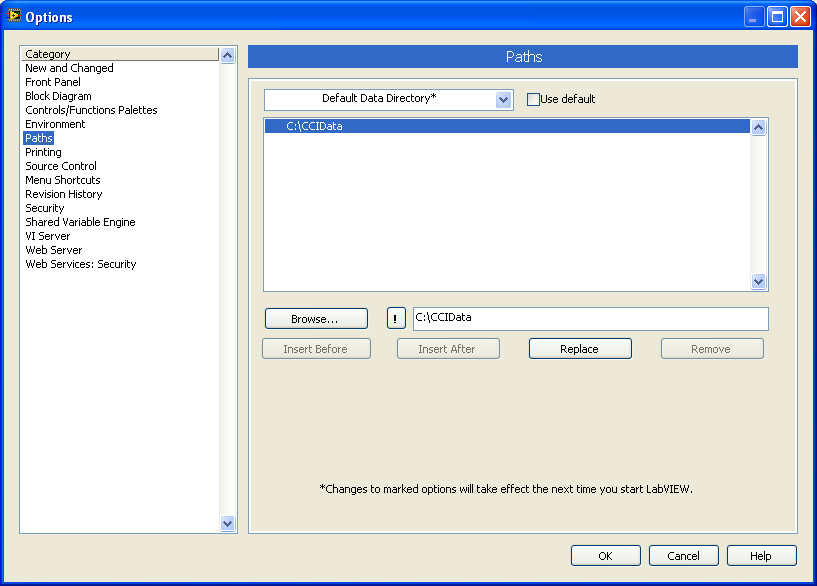

Great Question!  And you'll get several different answers I'm sure,
My approach is to use the default data directory for configuration files and a path relative to that for production data
of course, I do not use the default and here's a snap of my Options
Message 2 of 26
(7,494 Views)
But If I were to create an executable using that directory on Windows 7 I would no longer be able to write to it. It works fine in the development environment but as soon as I create an executable it no longer works. I get the permission error issue

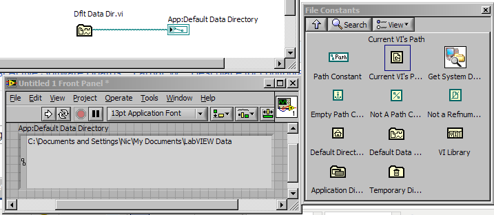

Yup, Windows Vista and 7 lock down the Program Files folder so that "user level" activity cannot modify the files within.  This is good design, and something you shouldn't try and overcome IMO.  You want users adjusting user space files, and not program or system files with the software they run.
I like how Vista and 7 moved "Documents and Settings" to "Users".  This is how Linux and Mac OS X are, and they are that way for a reason.  Because of this, I use the "Default Data Directory" file constant and make sub-folders from there.  I think in Windows XP the Default Data Directory is usually "C:\Documents and Settings\<user>\My Documents\LabVIEW Data" and in Vista/7 it is usually "C:\Users\<user>\LabVIEW Data".
20681i273A2821EEDBC212

Thanks for your response Nic,
I have never mucked with the registry keys before and am very curios about what the benefits would be of  "* Use the variable [INSTALLDIR] for registry keys (if you need any)." I am assuming that this will allow me to install the application to a relative location rather than a hard coded location.... How do I do this? Thanks for your help.
Also, if I were to use the Dflt Data Dir.vi in my application, is there a 1 to 1 corespondance between the path that this VI spits out and one of the paths here?
20753i810D78957D319949
It would be great to be able to get these paths within my code! Unfortunately I don't have LabVIEW 2009...
