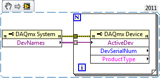

I'm going to assume you're using DAQmx to access these?
If so, try using the DAQmx System node to get all available devices, then scan through them to find the types and serial numbers available.
