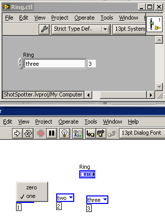

It's also easy to keep consistent across all of the VIs in the project, since it's a typedef.
Unlike an enum, the ring's data isn't really part of the typedef. If you drop a (strict typedef) ring constant on the diagram, the data is only up-to-date as of when the constant is dropped on the diagram; it isn't dynamically updated to reflect changes in the data of the underlying typedef. (And of course anything goes with non-strictly typedef rings, where you can set the strings at runtime.)
As for the best solution, I don't know. Despite the above problems with rings I have still used them for this purpose since usually the definitions don't change with time. Your idea of using an typedef enum + case statement in a VI seems like the safest approach for constants that can have duplicate or nonconsecutive values.

@Rob - I just went through your little example but trying different types of rings...and wow...that is really frusterating.  Is that a LabVIEW bug or a design decision?
