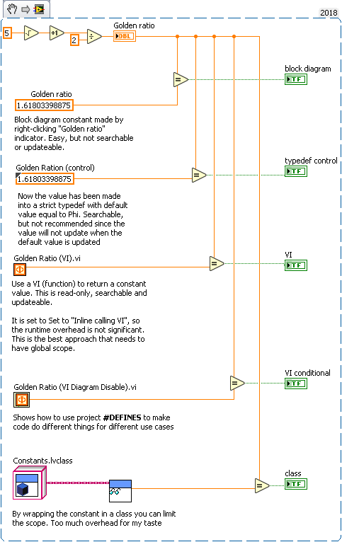

Generally I use a VI (e.g. a function that returns a constant value) for the use case you describe. Searching for VIs is fast, and it's easy to update this way while ensuring it can't be modified outside of the dev env. Setting the VI to "Inline in caller" removes the overhead associated with the function call, so this should be quite fast. Whether the data is stored internally as a block diagram constant or as the default value of an (unwired) control doesn't make any difference.
Here is a sample project (LV 2018) that shows a few other ways to do it. I've included an example of using a conditional disable symbol to create constants that depend on e.g. the target product.
I don't recommend using a bare typedef control with default value for this purpose as the value won't globally update. Using a class is appropriate if you want to limit scope.
-Rob
For more complex data types, I typically store the data in json format and deserialize it using JKI JSON so that.
