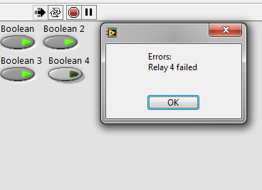

I am trying to find a cleaner way of doing the attached vi. In the vi I have booleans wired to case structures. If the boolean is false it sends a string to an array and into a dialog box.

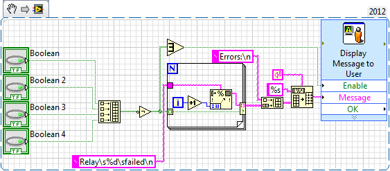

Build the booleans into a 1-D array.  Store the error messages in a 1-D array of strings.
Search through the boolean array in a loop.  For each true, concatenate the corresponding error message onto the string.

Use an event structure.

Think about the duplicate code, you have, and how you might eliminate 3 instances of it, and use the one remaining as a subVI to handle all the buttons.  Also think about how those four buttons could really be an array of booleans that could be parsed with a for loop, with each indexed boolean feeding into that subVI.

You need to learn to love that new conditional tunnelSmiley Wink

Thanks Jeff,
Your solution was the most helpful, it did exactly what I needed.

Love that new tunnel!
