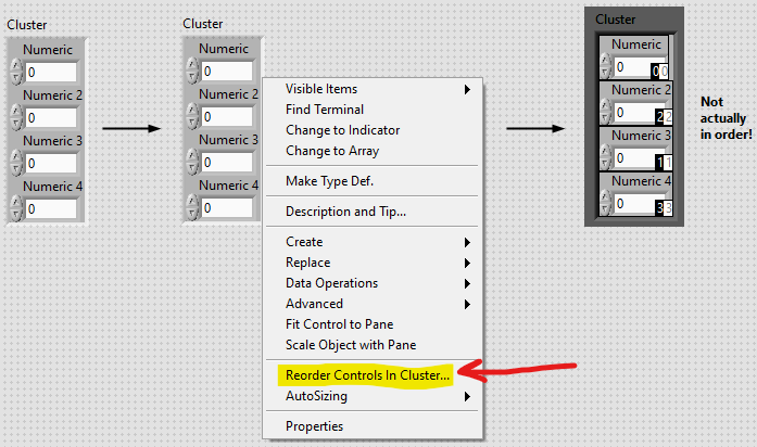

@MaSta wrote:
Means, the content of cluster element 0 will go into array index 0 etc, but it doesn't do it that way.
Can you produce code showing that it doesn't do it this way?  I've never had a problem with it not doing that.
Is there a chance maybe the cluster you're using has been arranged on the front panel to be visually in one order but if you look at the real order of the elements, it's not in the same order?
(1,612 Views)
Instead of convoluted descriptions, just attach a small example that shows the problem and we can tell what you are doing wrong. (Yes, most likely your cluster order is not what you think it is. If you create a cluster, the elements are ordered in the order you add them. As a quick check, right-click on the cluster and "auto sizing...arrange vertically". Now they will be in cluster order, first element on top. Did the order change?)
(1,604 Views)
Accepted by topic author MaSta
Ok, ok, I found out what happened. I actually re-ordered the cluster in one VI where it's a control, because I also wanted to have it in a certain tabbing order, then copied it over to a sub VI where it's supposed to be ann input control and now checked and the order of elements is totally garbled. Don't know how and why, because before I re-ordered it in the source it was not that garbled. However, re-ordering it in the sub VI now solved the problem.
Sorry for bothering you.
