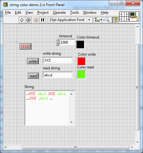

I wanted to add a feature to my RS232 swiss armay knife application.
Using one string indicator and show the written and read strings in different colors.
The attached program work, however since every update of string results in ONE color the solution found need an rewrite of all colors after each update which results in flicker 😞
and if you log some more data in the indicator it's a bad solution .
One improvement would be to only store blocks of same color ....
Someone with a better idea or solution?
Greetings from Germany
Henrik

Defer FP refresh seems to work.
Regards Florian

How about using a List Box instead of string control..  and having the sent and read text in different rows..& obviously different colours..

My first thought as well.
I did mine to emulate a protocol analyzer where send and recieve are on different lines and also wanted to flag protocol errors so I used a picture control.

Use these to write strings to a picture control.
