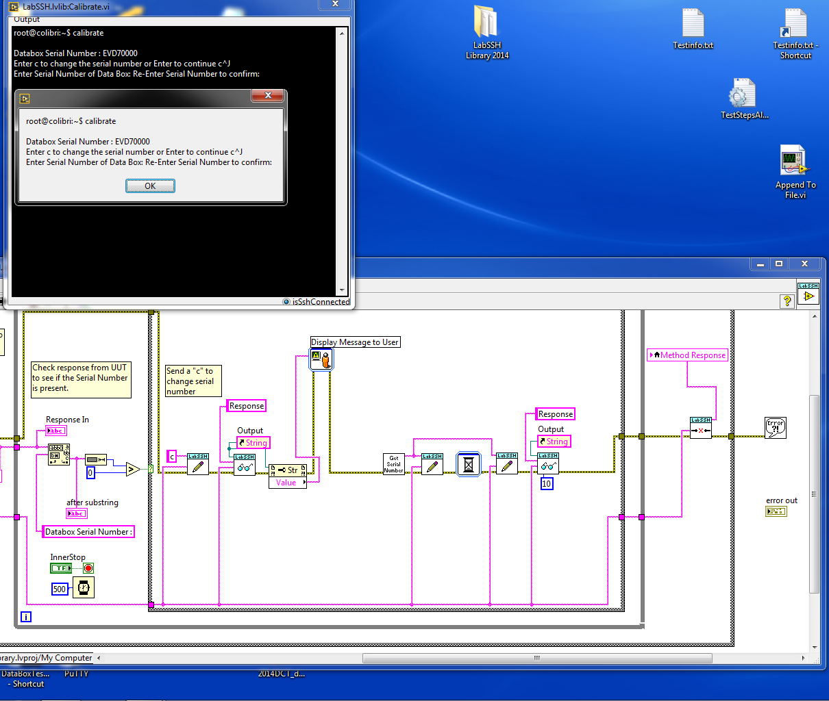

OK, fella's these tools are great and I am happy that Greg was kind enough to post them.  I have made some progress but am now, once again, stumped.  When I write a single letter out to my end device (the letter being 'c') I am actually sending c^J.  I put in a message box so I could pause execution and grab the following screenshot.  What am I doing wrong (and I assume I am).  THANKS!!!

Hi John,
I'm glad you are making pogress. One thing that might be happening is that when you send 'c', a line feed (\n) is automatically concatenated to the string to simulate the return key being pressed. This is done by the dll.
When trying to change the serial number, the device might be expecting 'c' only, without the line feed. Have you tried to do this process manually using PuTTY? What are the process steps?
I'll compile a new version of the dll that does not concatenate a line feed so you can try it out. You will then have to concatenate a line feed to all the other commands you input to Write.vi.
Do this for normal commands: (This change only applies to Write.vi)
Do this for commands that do not require a line feed:
I've DM'd you a link to the new dll. I've versioned it 3.1.0.4.

Greg,
You are absolutely correct.  In PuTTY, I just enter 'c' without a carriage return so the line feed is probably the issue. I'll try the new DLL.  Being a rather remedial LabView coder I try to power through things to see if I can figure them out on my own.  But one thing I don't understand is how the .DLL's come into play.  Is it as simple as deleting the old one and copying the new one in its place (in the...\references directory) or is there something I need to do inside of my project?

Hi John,
Just close down all your LabVIEW code and the LabVIEW getting started window.
Copy and replace the LabSSH.dll in the references folder of my library.
Open your LabVIEW project, this will cause the conflict dialog to open which you can just skip through as it is only indicating that the dll version has changed.
Add a line feed to the commands where you need them in your LabVIEW code.
That should be it. If it doesn't work then let me know and there is another step that you could do.
