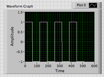

3. I am assuming that you will get a signal which looks something like this, although not necessarily starting exactl at zero time or having exactly uniform spacing between the pulses.
Using some simple logic you can determine the time of the transitions between high and low.  The differences between the times of successive transitions are your periods.  For the image above the falling edges (going from +1 to -1) occur at about 64, 192, 320, and 448.  The differences are 128 in each case.  For your impact data the differences are likely to not all be the same as yout target decelerates.
After I see you VI, I can give some suggestions about how to proceed to calculate the differences.
