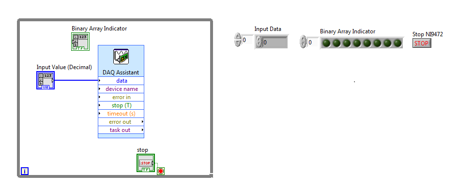

I have NI 9472 which is a digital sourcing device, I have no problem to control it using LABView to output the result (line 00000000).  I also would like to have some indication on the computer screen using LED array.  I am able to create an binary array indicator but fail to connect the decimal input to the binary array.
Please help/provide some hints, it is appreciated.

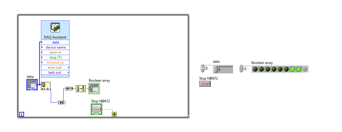

Thank you very much!!! Just an additional question - how can I reverse the binary indicator - the MSB is now at the end. I tried "reverse 1-D Array" but still the same.

You use reverse 1-D array.  There is no way it's the same unless that happens to be your bit pattern.  Post an example.

Your understanding of LSB and MSB are backwards. The LSB is on the left. Why don't you simply use a numeric indicator set for binary display? Otherwise, someone who actually understands how an array is displayed, is going think something is wrong.

How do you figure you are losing a bit?  Your original screenshot showed 8 LED's.  Converting to a U8 gives you an 8-bit number.  I don't know why you are starting with a U32 array.

oh - I missed count the LEDsSmiley Embarassed

I'm with Dennis.  Just use a numeric indicator.  Set the representation to U8.  Right-click on it and select Visible->Radix.  Right-click again and choose Display Format.  Choose the Advanced editing mode and put in %08b.  The result will give you an indicator like this.
