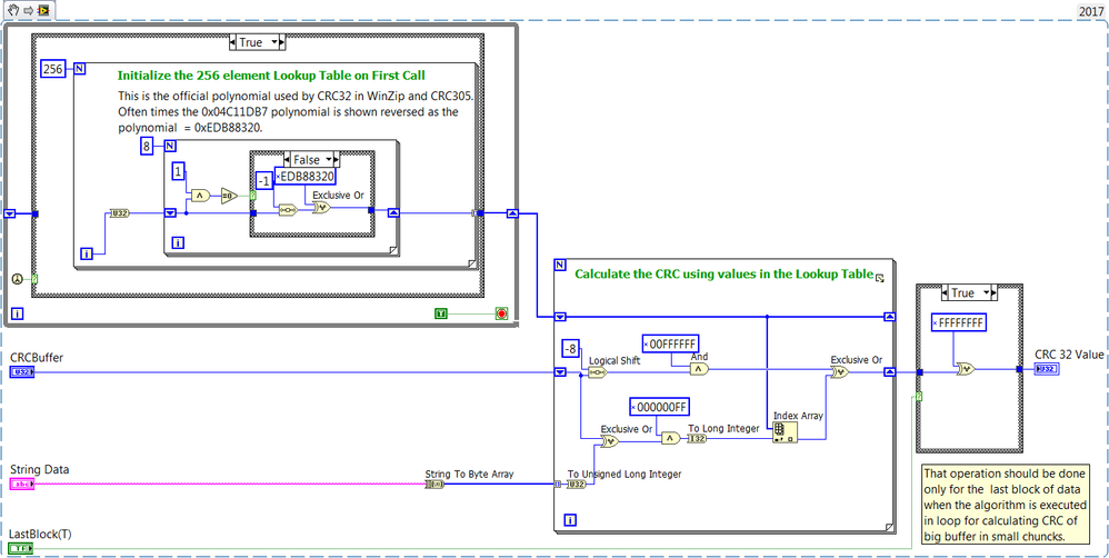

@Barionics wrote: I don't really want to go down the spaghetti route if I can avoid it.
There are several examples in these forums for CRC algorithms that are not spaghetti at all.  My baseline CRC code is just 2 FOR loops with shift registers, bit shifting, XOR, and a case structure.  If you can supply the C code and example results (input ABCD yields and output of XY), then we can give it a try with what we already have.

The problem is that there are many variations of CRCs (8-bit, 16-bit, 32-bit, shift left, shift right, different initial CRCs, Invert or not the final CRC, polynomials, etc).  That is why I asked for a sample of inputs vs outputs.
Here is what my standard 16-bit CRC code is.  I can usually find the right combination of settings with this VI.  If not, then I want to see the C source code to figure out what they did differently.
