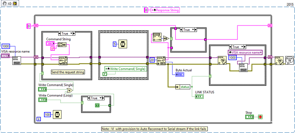

Like this ? Checked and this seems to work … any further refinements to this need be done ?

Just a couple of comments:
  1. That "Write Command (Loop)" button with the Case structure is a pure Rube Goldberg construct. You do not need the Case structure. Beside, you should use the "Latch until released" mechanical action for the "Write Command (Single)" button, so you do not need to switch it back via a Local Variable!
  2. So actually that 5 msec Wait and the Local Variable in the Sequence Structure is not needed, delete the whole Sequence frame! If you use a proper termination character for communication, the VISA Read will wait until a msg comes in with a termination character, or until it reaches the configured timeout. If Timeout happens, handle the error as you need to!

Thanks @Blokk. Valid points.
About the Rube Goldberg ( whoever it is !) :  Initially I had a construct to write the SEND command once in every multiple time delays to try out various scenarios. Finally I found that 100ms is optimum but forgot to remove the Case !!
After the refinements the VI looks simple ( and efficient )
