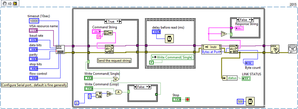

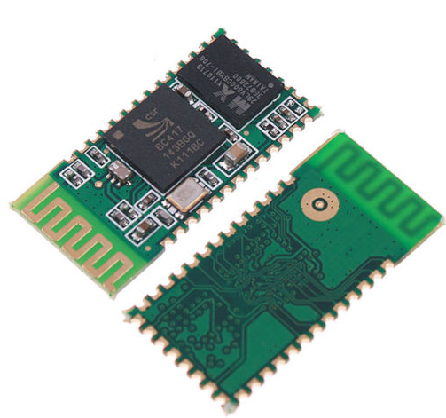

I am using a Classic Bluetooth module like this linked to a Arduino to send back some characters when the connected host sends a request like <send> .
The snippet below works fine with standalone modules like HC05 . But does not even link with the SMT versions. Do the SMT versions need additional level translators or something like that ? I am powering them with 3.3V.
Example
Example of Standalone module :HC05 Standalone.PNG

Anyway to answer your question, no as long as you are using 3.3v logic. As the "stand alone" versions are just the SMT board mounted on a carrier that has a voltage regulator and level shifting on it to work directly with 5V Arduinos.

Ok following the suggestion given by RTSLVU I have created a simple VI that converts the BT into a simple Serial COM.
Matters are so simple. Of course certain behaviour of the Serial functions is now different :
In a normal hardware serial, if the connected device is removed or powered down, the VI will call a error. But with the assigned Serial COM for a BT device, I see that this does not happen . I think Windows retains the assigned BT irrespective of the actual BT link and so this VI hums about happily without crying foul.  Is this a boon or bane ? It may depend on your needs. For me its a boon as the BT device is a battery powered one and so goes to sleep when not needed. But when alive the VI is ready !!

Do not use the Bytes At Port.  Your data should end with the Termination Character, so use that.  Just tell the VISA Read to read more bytes than you ever expect back.  It will stop reading when that Termination Character is read or a timeout occurs.  Along with this, you can get rid if that wait.  I would probably lower your timeout to something more like 1 or 2 seconds.

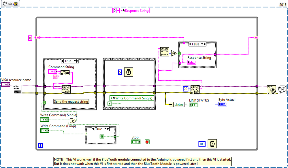

Based on the suggestions given I have modified the VI and it now works without using the BT functions and just linking to the enumerated Serial Port created by Windows when pairing with the external BT module. ( The BT module HC05 is interfaced with a MCU that is programmed to send back a Numeral string in response to a request <send>
In this I have two issues :

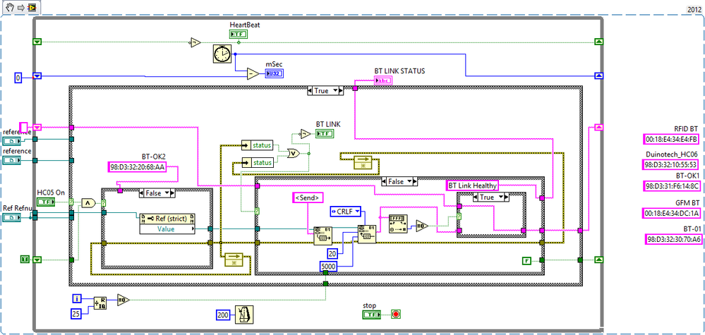

1. The communication happens only when the HC05 is first powered up and then this VI is started.  I can see why … the initialization of the relevant Serial Port is over by the time  and when there is no response to the <send> command this VI reports an error.  Question is how to retain the VISA reference once it is started ?
2. I tried to use the "Is Port Connected " property to identify the link failure and initiate another instance of Initialization of the Serial Port but it does not work … so how to really find out if the Serial Communication fails ?
